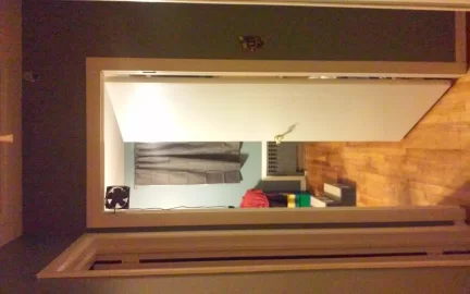

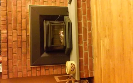

I'm Trying to move the air from the stove room ( insert) to the bedroom which is directly behind but 22' away. I installed a doorway fan and that is not working. The stove room temp is 77 degrees , the bedroom is at 73 degrees ( only because wifey had the base board run until it hit 72 degrees) , but the area over the bedroom door (transom ) measures 76 degrees. My question is if I install a wall grille at the transom do you think that 76 degree air would travel thru to the bedroom with natural convection ? Not using that fan ? I attached pictures to view . ( yes the stove room is cathedral at 15'-6" )

Did that once before with a small floor fan in the bedroom & did not work.I do believe the ceiling does help move the air around , but trying to get this warm air into the bedroom is a challenge !
I would get that little fan or something similar down on the floor. Up that high you are moving the warmest/lightest air in the room against colder/heavier air. This is a self defeating process. Get it low and put it on low and leave it there all the time. Eventually you will get a convection flow that is pulling warm air into the bedroom. That and get a mattress pad that plugs in and has the dual side heat option. You wont like it on high - but it sounds like your wife would.
Tape a piece of TP at the top of the doorway, and you will be able to easily see if you are moving air into the bedroom, or not.
I have a threshold at the door to the bedrooms, I reckon you do too. I think the warm, lighter air takes the easier path around the threshold, staying in the stove room.

Yes my main hot spot is at the threshold above the master bedroom door ! If I can only get that air to pass thru the door opening ,that room would definetly rise in temperature.

Thank you for the reply. I have one small fan on the bedroom floor blowing the cold air out of the room,& yes it raised it up about 2degrees ! Again the insert is 22' away from the bedroom , maybe I will add a 2 small fan at the 1/2 way point so it's like a relay ?
I didn't see an answer to the t.p. test suggested by Jeff. Did you try it? If a fan is blowing from the bedroom to towards the stove room that air will have to be replaced by warmer air up top. I'd put one fan on low blowing out of the bedroom and another fan on low blowing into the stove room. After that it is just a matter of time. The t.p. test will show the movement of the air. My own problem is that my insert is simply too small to yield the results I want.
