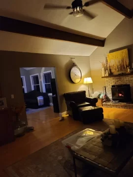

I know this has been discussed a 1000 times but I am lost and can't move air!!!
Possible to look at my pictures and tell me how to get air to the back room.

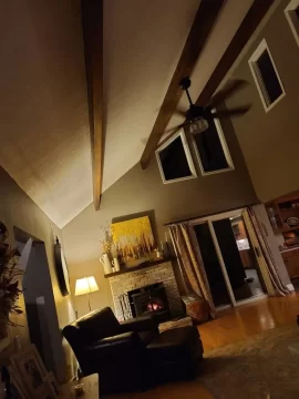

The room with the stove has cathedral ceilings and the fan is currently set to winter mode. This room is currently 70 degrees.

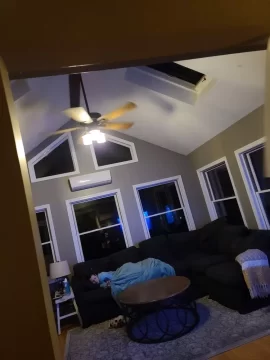

The backroom is is currently at 62 degrees. There is a ceiling fan set to winter mode and the ceilings are vaulted.

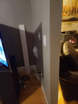

I also purchased an in wall fan to move colder air from the back room to the main stove room. This seems to have little impact.
Thanks

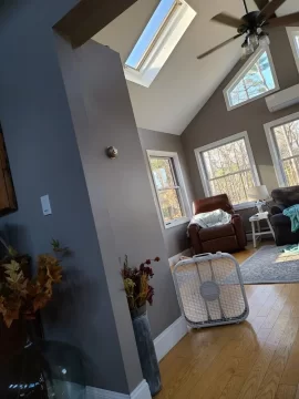

It's going to be a challenge. At 70º the stove room is not too hot. The back room has a lot of windows and a high peaked ceiling. It could almost use its own stove. You could try moving a larger volume of air than that wall fan is capable of. Do you have a 20" box fan? If so, try placing it about 6' into the cold room on the floor and run it on medium speed, blowing the cool room air into the stove room.

Thank you for the response. So the fan I installed in the wall was a waste of money? I'm gonna hate to tell the wife she was right!!!
I do have a box fan and will give this a try tomorrow

I run my fan counter-clockwise in the cold, that way it goes up ceiling, grabs the heat and comes down the walls, this give a much more even heat and not as drafty, so play with that, it's different I know but works better for me. I put a portable oil-filled heater for the back back room to just take the edge off and that works good too. Also, get out the IR gun and some incense and figure out the air flow/leak and let natural do the work.

Take the stove room up to at least 75º and use the box fan in the other room to cool it down by blowing cooler air from the back room into the stove room.

Is the mini-split in the back room a heatpump or just AC?
Thanks for the reply everyone. Today I added the fan to the back room and walla. Stove Room = 70 / Back Room = 68

Count me as another vote for a tower fan at lowest speed. In my case, I think that high speeds disrupted the convection loops in the room, causing worse results than no fan at all. Tower fan at lowest speed blowing cold air into the stove room worked wonders.

Is it too cold for the heat pump to heat this room?
It's not to cold. I'm just cheap and hate to pay eversorce for electricity :-)
