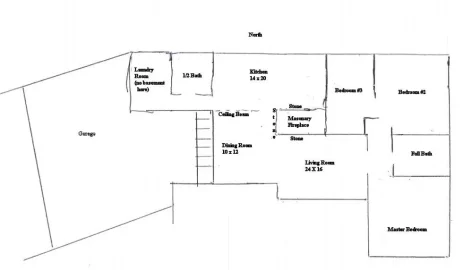

I would love to post a diagram! Is there any 'freebie' program to design one?
Shari
MS Paint should be on your system if it's Windows.
Hopefully our floor plan will be showing in this post.
I am trying to figure out how to get warmed air to the bedroom wing. The other rooms should be fine.

Nice job Shari!
I would start with a table or box fan on the floor, located in the hallway, near the bathroom door. Point it towards the stove and put it on low speed. The object is to blow the colder air toward the stove.
See how that works for a few days when it's cold outside and let us know what you find out. Of course this is after you've picked out your stove and have it up and running.
Thanks for the compliment on the floor plan - quicker for me to just draw by hand and post........
With the current fireplace we get a lot of thermal heat radiating off the stone back wall of the fireplace - keeps the kitchen toasty for hours after the fire is out in the fp.
We have a couple of 'upper' obstructions: The dining room has a wooden ceiling beam between dining room and kitchen and the bedroom wing doorway has a transom (which we may open up a bit for air flow).
