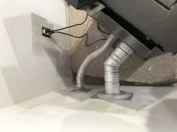

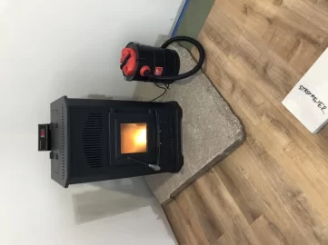

Here’s some pics of my current setup. One 45 due to being in the corner then straight out to a clean out and up 4/5’ to the cap.
Thinking my best option is to move the stone up 4-5” so it’s on the right plane to be level with my thimble.
I’m learning the hard way to “buy once, cry once”..

I would make a frame out of wood the height needed put a
nice finished pine or oak around the edges to the floor. then
place the stove cap on top bing raised hearth

When I had my P43 installed the dealer showed me the pad, and after watching him demonstrate how to clean the stove and him down on the floor crawling around I asked if it could be raised. They had the local lumber/furniture place make me a nice oak riser about 6" high to place the pad on. It works out well.
If you could find some nice stone to match or accent your stone pad, I think that would be nice to put under each leg of the stove. I guess the problem is finding them just the right height.
