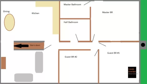

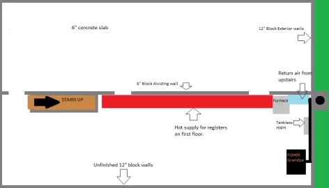

So, I'm asking the same question as many others have before me.. But like the others, each situation is a little unique. I'm trying to move the wonderful heat my Fisher Grandpa puts off for me, upstairs.
My basement is unfinished and is built with 12" block all the way around. A 6" block dividing wall with 3 door openings seperates the two sides. The Fisher is in the far corner of the house, opposite end of the stair well. The stove is under the bedroom side of the house. The stairs also are facing the opposite direction of the stove as well. The stairs facing the opposite direction I think is what is hurting me the most.
The Fisher gets the entire basement area to about 72* even on the coldest nights, (lately 10* or colder). Which I think is pretty good for an unfinished basement, with exposed block walls and 6" of concrete. However the upstairs is usually only around 62, on the same cold nights. Right now I'm leaving the basement stair door open, obviously.. And have my furnace fan on circulate to hopefully draw the heat up the stairs.
My question is, what other/better methods could I use to get more of the heat upstairs?
I've thought of a few floor registers in the living room near the stair well will let up more heat. I know finishing the basement will help a tremendous amount, which will happen, just not ready for that at this time.
I've also thought about cutting another return in my return duct in the basement at the unit to draw some of the warm air from the stove into and disperse it thru out the house. I know this is frowned upon by many but these are just ideas for now. Also my return duct/furnace is about 10' from the stove now.
I've attached a diagram to help explain the basement layout.

Insulating the walls will help a lot. If the basement is currently only 72F then there is not a lot of extra heat to make upstairs comfortable. After insulating there needs to be a convective loop established. This may take adding vents so that you can blow the cooler upstairs air down the stairs to be replaced with hot air from the stove. Of course the best place for the stove is upstairs, it is an area heater that should be located where the heat is needed.
Yep, I'd insulate the basement walls to raise the temp, and cut 2 holes through floor above stove. After it rises upstairs it will cool and drop down the steps. 1 or 2 small fans in the vents blowing up will help.
If the steps and stove were at the same end of house it would rise up the steps and you would need fans in floor register vents blowing back down at the opposite end, but your configuration is better to gravity convect with or without fans. The only down side is the bedroom will be the warmest. That's the natural circulation loop that can't be helped with the stove under bedroom.

You don't want the heat piped to the upper floor next to where it comes down when it's cool. It wouldn't circulate through the rest of the house. You want the lighter more buoyant warm air to rise upstairs, and as it cools it gets heavier and drops. That makes it rise on the stove side and cooler air falling down the steps allows it to move through the house keeping it more even through the house. Admitting hot air near the cold air return (steps) allows it to cool and drop down the steps giving you cold uncirculated "dead" spots in the house. That's it's natural path that gravity (hotter lighter, cooler heavier) causes it to circulate. It's easy moving it in the direction it wants to go.

A better way to balance yours would be two vents in hall at stove end, and one with a small fan blowing up through a vent at the other corner on the stove end. That makes it more even at the warm end to migrate through the entire house as it cools headed back down. That eliminates stagnet areas with no circulation.

Post a sketch of the first floor plan so that we can see its relation to the basement floor plan.

Thanks, the diagram is very helpful. I would have an insert or a freestanding stove in the living room fireplace and be done with it. Otherwise a large floor register in the hallway would probably be the best bet, after the basement is insulated. Next to that, selling the stove and putting in a wood furnace is worth considering.
