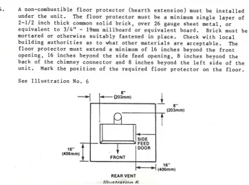

What that describes is a manufacturer's hearth requirement consisting of a good deal more than just non-combustible ember protection. A stack of a brick atop a piece of sheet metal or a brick atop a sheet of millboard...that's telling me that some R-value is necessary. I'd make a real rough guess that the brick/millboard stack would have an R-value approaching 1.5. I don't know what to suggest other than contact your local Authority Having Jurisdiction and come up with a plan that makes everyone happy.
Short of that, if it were my house, I'd at the very least lay a sheet of 26 gauge sheet metal down then the decorative stone/tile/whatever on top of that...meeting or exceeding the size requirement shown. Rick

My manual for the stove keeps referring to brick but I'm assuming because the maual was printed in the 80s it's probably dated? I'm sure that tile and stone would be acceptable?
Here's a scan from my manual......

My wall is 13-1/2" from the stove pipe but I'm putting up a brick or stone surround along with a stone base for the stove to sit on.What kind of wall is behind the stove? If it is made of combustible materials you cannot move the stove closer than 25 inches from the wall. The single wall stove pipe must be at least 15.5 inches away. If there is a side wall it must be 27 inches from the side of the stove. This information is from the label on the back of the stove. The same label also requires a hearth pad of at least 3/4 inch asbestos or equivalent. I'm not sure what the R value is for 3/4 asbestos but 3/4 inch mineral fiber board on 26 gauge sheet metal with a cement board/tile top should probably do it.

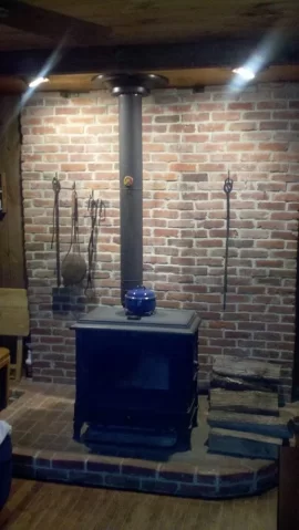

If you decide on going for a new stove, can you post a bit more information about the house and space that is to be heated? A picture of the current setup would also be helpful. And let us know a bit more about the style stove that appeals to both of you.

That's true, but when I asked for the quotes I was intending on putting my old stove on it. I'm hoping to go looking tommorow but most of the stove stores around here are closed for the long weekend.I would choose a stove first then get quotes on the hearth. You have to make sure that the thermal resistance ("R" value) of the hearth is adequate for the stove.
