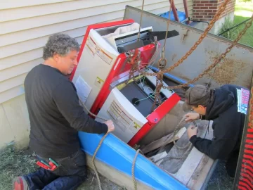

I took your advice and contacted a tow truck guy. He came over to look at the moving job. The boiler owner and he couldn't find the eye hook on top of the boiler. Do all Tarms have one? I think the boiler was made in 2005 or so. The trucker also said he had some "skates" we could use to get boiler to bulkhead across cellar floor, anyone know that terminology? Thanks
Did you take the top skin off & look as suggested above?
My boiler didn't have a lifting eye, the recommended thing to do there was screw a nipple & T into the top centre piping tapping (tightly) and lift by that.
"Skates" are most likely heavy duty "furniture dollies" for moving machinery, etc.

So I asked the homeowner to look on the top of the Tarm for an eye hook to lift it with. I believe this Tarm Solo plus was built around 2000, do you think some Tarms were made without the eyehooks?
Well we got the Tarm home and installed and have used it a few days. Of course it was -13 when we switched the boilers but it has kept the house warm. The last few days I have been tweeking the unit, turned down the fan and added chain turbulators. I'm making progress and learning alot and staying warm. I think one of my problems is my firewood is only14" for my old non gasser boiler. It is very dry though so that is a plus. I was able to get it up to 190 operating temp after 3 hours and then it started cycling for 10 hours. I think I'm headed in the right direction and no sliding backwards.
