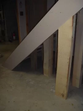

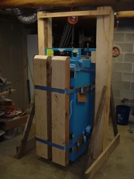

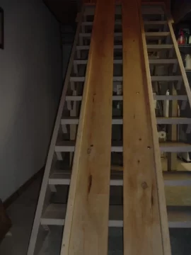

I just moved my 1500 lb Econoburn boiler out of my basement to its own shed in the fall. I didn't want any surprises so I braced the stairs with wood beams, then made a heavy duty ramp up the stairway. On the boiler itself, I took off the doors and made wooden skis that attached where the doors were . To position the boiler, I used a borrowed pallet jack to get in to the stairway, then tipped it onto the ramp with a chain hoist and pulled it up the ramp with my tractor. Here's a few pics of the operation- all the prep work made the actual move a piece of cake with no surprises. Bruce
