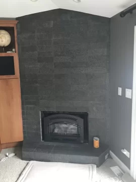

We currently have a Travis Industries gas burning insert that was put into an existing pre-fab and then tile was added to the surround in lieu of a metal surround panel (See photo). While we love this unit and it gives off plenty of heat, we miss the romance of a wood fire and the gas unit itself is getting up there in age. After discussion with a certified (NFI gas and wood, and certified chimney sweep) hearth professional, turns out these units are installed into existing fireplaces so after paying them to cut out some tile, we discovered our pre-fab fireplace which we did not know we had. Based on a few pictures of the circa 2005 remodel performed by a previous owner, we can glean that our pre-fab/ZC fireplace is made by Majestic (see remodel photos). We have no other information on this unit (no tag, no serial number, brochure, nothing but a white label on the chimney that we cannot get to because it is walled off by drywall and stone tiles.)

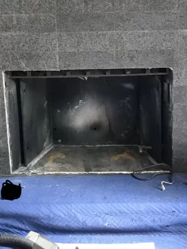

After removing our current gas insert and inspecting the fireplace and chimney, it is our hearth professional's opinion it is in good enough shape to house a wood burning insert. The firebox is quite small, so he is currently recommending the only insert that will fit: Lopi Answer II (which is the Answer but updated for 2020 EPA requirements). We love this stove, its perfect for us - we are just trying to add supplemental heat to our ~800 SF main floor and den area. My concern is the safety. The only thing I know about the existing pre-fab is that is is made by Majestic, and I only know this based on a picture taken in 2005 or 2006 while remodeling the addition. There is no tag or identification whatsoever in the firebox, and there is no manual in the crate of receipts where these pictures were found. We do not even know if the previous owner put in this Majestic (making it new in 2005) or retained it from way back when. The addition was built in 1979 per our building department and the "MAJESTIC" ink on the external fireplace seems old - so its possible this is a relic from 30+ years back. It is my understanding that installing a wood burning insert inside an existing pre-fab is pretty controversial, but as long as the existing pre-fab is in good shape and was originally listed to burn solid fuel (UL 127), you could make the bare bones argument that its safe (even though its not 100% agreed upon in this community). We have told our insurance company about our plans, and they are fine with it but did not inspect anything or really ask any questions, just gave a blanket $25 per year premium for "solid fuel". Additionally, someone in our family is a fire inspector for the neighboring town, he thinks our plans are totally safe and whatnot based on pictures I sent him as well as the Answer's manual. Everyone else thinks I am overthinking this.
My concern is that based on pictures of the empty firebox, it really strikes me as odd that there are no refractory panels; this thing really is just made of three air separated bends of sheet metal. My installer said he contacted Majestic and they told him some models did not have refractory panels, but had an extra layer of metal instead. This strikes me as odd, because even though wood burning pre-fabs are lesser quality than their full on masonry counterparts, they are still at least rated to have open wood fires in them. I guess my question is, based on the pictures, can anyone ID this unit of fireplace or comment on the overall safety of this install? I am no expert, so I do not necessarily want to offend my installer just yet if he (and you all) know something I do not know. Again, he and most of this staff are NFI certified and this is a family business that has been around a long time, so they seem like they know what they are doing and I trust them. I normally would not trust a sales person trying to make a sale, but hearth businesses are not built by people who burn down their customers' homes. Its just that based on the appearance of my current pre-fab, it does not seem a snowball's chance in hell that it could (or ever could) handle an open wood fire and if that is the case, I cant really see how having a 300 pound flaming steel box in it can be any safer. The installer did say once they do the install, I can never have a wood fire in this again - so he seems to think this thing is rated for wood.
My fear is that perhaps this pre-fab was a gas only unit back in the day. If this thing was originally rated for gas only, and we stick a wood insert in it, that strikes me as very unsafe and something to be avoided. I am also not entirely sure of the hearth extension and what it is made of. Its 16 inches deep, with half inch stone tile, so maybe this thing was made to burn wood (16 inches, from what I gather, used to be fire code), but there is also an outlet on the side which makes me think its hollow (also it feels solid and the pictures of the remodel show some white brick before the tile was added - Remodel #2).

The problem is there are no majestic fireplaces that old that allow for the install of any insert in them at all. Because of that doing so would be a code violation and because it is untested we have no idea what potential safety problems there are.
