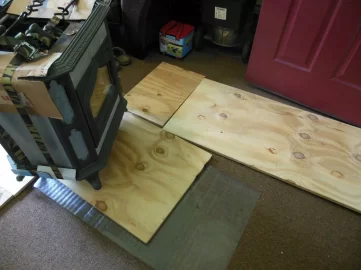

Built a ramp to reach my 6 inch high hearth.. Worked great,,, after shimming up the stove legs, I installed my dolly then strapped the stove down.. Wife removed the wood from under the legs as I lifted the stove,,, wheeled it down the ramp and then moved the ramp for one more move out to the back room, moving small sheets of plywood as we wheeled. Next it goes out the back to where it will be lifted with straps by my tractor , then the original shipping pallet will be placed under neath for it's ride back to Woodstock.. Planning to get my new Hybrid back in and onto the hearth the same way,,, Wow, did wheels and a ramp make it easy... no damage to my hearth fascia or the stove...

My dolly is small,,, 12 inches wide and 18 inches deep, fits the Fireview perfect.. Just added a 2x4 at the front and back contact points.. It's like it was made for the Fireview... Wheels and ramps make it an easy , safe job ..Plus no worries of damaging the stove...I just took the top off to move the Fireview. Door and brick don't seem to be a big weight issue, of course I guess every pound adds up... My thoughts were to make my ramp long and low instead of short and steep.. It's nice to have control of all that weight.. Hopefully the Progress will move as easy... I'm thinking of lifting the Progress off it's pallet with straps and my tractor forks when I get it set outside my back door, then switch it to the dolly I'm using now so it is lower to the ground to move... Then onto my hearth, start shimming the outer sides of the stove with wood, adding wood to the dolly until I'm high enough to install the legs.. Then add wood to the legs, slide the dolly and wood out , then remove the wood from under the legs. Meanwhile while on the dolly I'll try to get the stove in it's perfect spot.. If not I'll add some furniture slides afterwards so I can tweak her into position.. I can't believe the Progress will be 300 pounds heavier!!! Still deciding if I should get the ash pan or not.:confused:

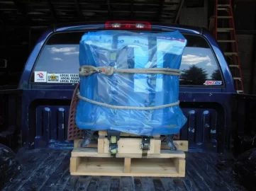

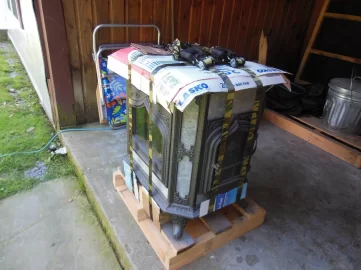

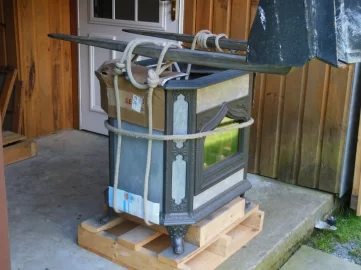

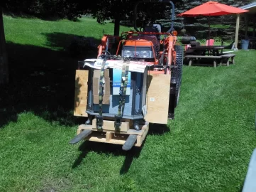

Did the rest of the move today by myself.. Scariest part was lifting the stove with ropes and my tractor so I could swap out the dolly for the pallet.. Took about 5 tries until I felt the stove was balanced on it's own...I had no one to hold the stove while lifting it.. She's all strapped and protected with card board, double card board on top to protect the stones...

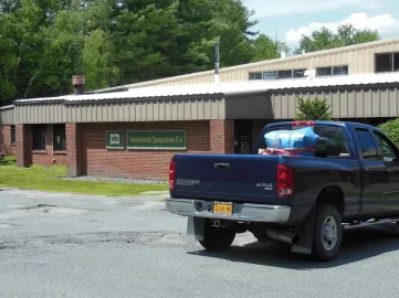

Well your stove is at Woodstock,,, Jamie looked at it and said, boy this won't need much cleaning up at all.. So there U know I took good care of it.. Still looks like new...
Here's your stove at Woodstock..
