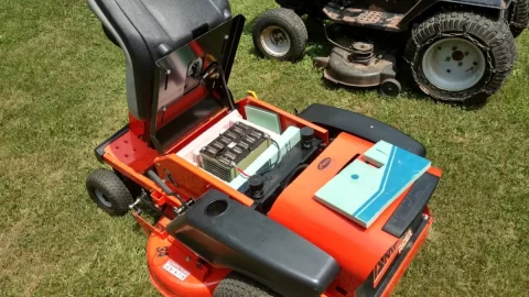

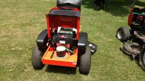

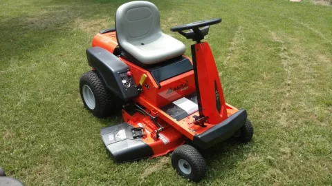

I recently picked up an Arien's Amp electric rider. The stock batteries were shot so I've installed 48 VDC worth of Chevy Volt battery in there. One brushless DC motor runs a hydrostatic pump that drives the rear wheels and 2 smaller DC brushless motors turn the 2 blades. Its definitely not a heavy duty mower but my wife loves it for trim work and she'll like it even more when I add a hitch).

Edit: we also have an electric push mower that I converted from 24 VDC of AGM to run on 2 Ryobi 18 VDC power tool batteries (with a voltage regulator).
