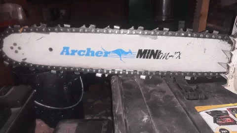

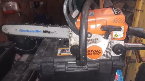

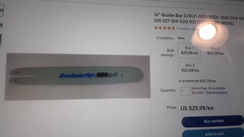

I own 2 MS180 saws. One since 2009 and bought another a couple years later and absolutely love them and harvested several hundred face cords with them. Of course brand new they came with .043p chain and bar. Later I moved to using .050p chain and bar. This year I broke all the rules and started using full size 3/8 .050 chain on an Archer MiniMax .050 lp bar and believe it or not this combination works. The chain is not bottoming out in the bar groove and the nose of the bar has a large enough radius that there is no issues with binding. I've cut approximately 50 face cord with this combination with no notable loss of power. 3 of the trees I cut were in the 24"+ range.
