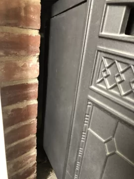

So that’s where I am right now. Fortunately we have a zoned furnace backup, but that’s 3 times as expensive on a monthly basis. Also, the store whose tech guy came out is closed today. Is there anything else I can do? I’m not tech savvy nor an electrician; I’m hoping any fix will not require either. Also; as the photo shows, the panel on the left side (as you’re facing the stove) is really tilght to the wall. I would like to minimize getting into that side of the stove as much as possible.

I hate when they take a freestanding stove and try to make it work on the hearth. I had 1 I refused to service because it is partly in the fireplace and you cant get to the back of it without pulling in out into the room. It was a Harman XXV. 300-400 lb cast iron stove.
I feel for you; I spent an hour scraping my hands trying to unscrew the left side panel so I could unplug the auger motor. I only put two screws back in, it was so bad
