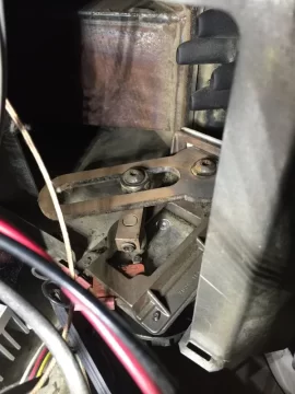

removed the autoclean mechanism, did the magnet trick (Thanks Kap). If I hold the motor lever during the autoclean sequence, I can feel the lever alternating between tight and then suddenly loose, which seems to confirm my prognosis. I think I need to get access to the motor area and see the connection, no idea how to get back there. No videos I found go that deep either. Any ideas guys? I am taking pics, so I can do a writeup when done to help others out. Thanks for any advise
[Hearth.com] Mt. Vernon self clean malfunction !
As I stated in previous post, take left panel off. You will see a silver plate over motor area. You have to remove things to get at it. kap
How did you get such a good shot of that area?

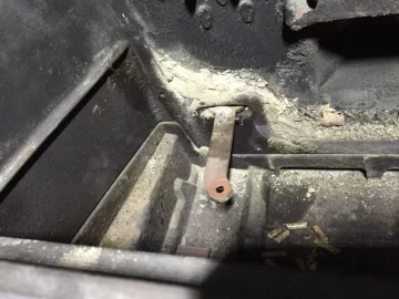

Not suppose to remove chamber floor. Make sure you reseal it real good.
Front by window has gloss tape on it
Late in following up, but it turned out to be what I thought...the set screw had come loose on the linkage to the autoclean motor.
