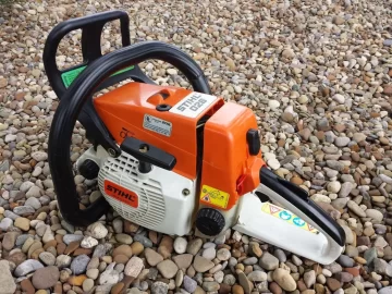

I have a minty 026 if your looking for a nicer smaller saw to trade on? This saw has a nice Muff Mod. Runs great with full rebuild. Only 2 tanks since...

Here is a pic if you are interested in getting rid of it, rather than Moding. T

Wow that 026 looks mint!
That 026 is purdy, Dexter, but no way am I running a limber like that for my mid-size saw! I'd be trading the 036 for an 044, if anything at all.
