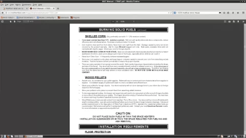

This is page 7 in the manual for the 6039/6039I/6039T that I am reading does this match your manual?.
[Hearth.com] Multifuel: what can I burn?
I missed the cherry pits but the point is you can only burn what is listed in your manual. I just want to verify I have access to the same manual you got with the stove.
