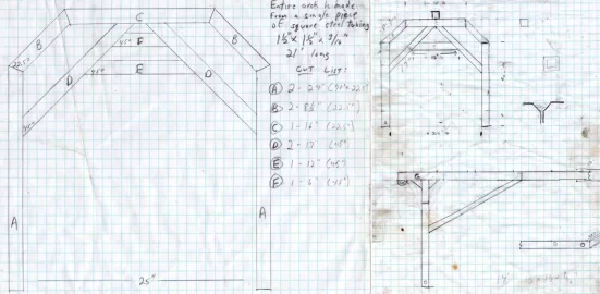

I'm collecting parts for a logging arch. I have an old rusted out utility trailer that I'm going to use for axles/spindles/wheels/tires and a friend is picking up scraps for me from his metal shop for the rest of the build. I found an unused pair of large Dixie skidding tongs on CL for $50. I hope to have it built by summer. Check out Battenkiller/drfera's arch at https://www.hearth.com/talk/threads/my-new-log-rite-log-arch.69837/
I'm using Battenkiller's plans based on his measurements of an early version of the LogRite Junior:
  • [Hearth.com] multifunctional logging cart

I think the LogRite Junior is a better design for a hand powered log arch.
