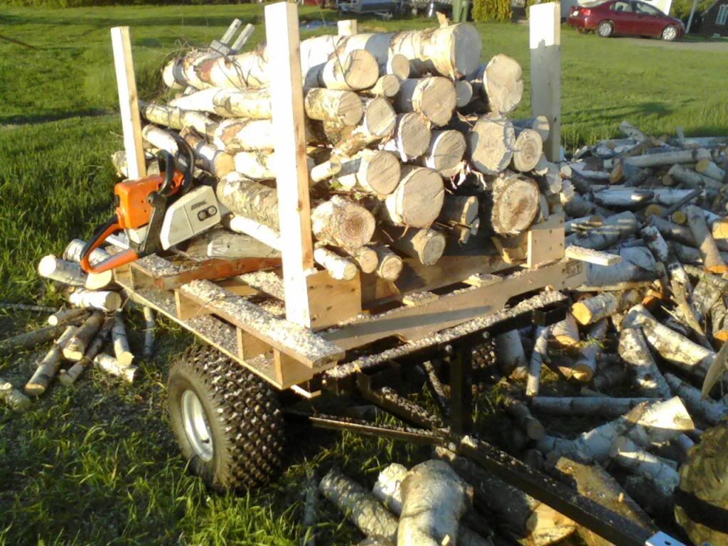

Have a trailer? Get a sawbuck thing set up on your trailer, load it full where you get your wood at, then cut it to length right on the trailer when you get it home.
That's what I do with my ATV & trailer. And I also have a wonky back. Helps immensely and also speeds up the process.
Doesn't take much to make a sawbuck setup. Just some high wood bunks across the bottom, and some wood uprights down the sides.

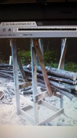

I've got tons of pallet wood to build a jig from. Sometimes I use my truck, sometimes a trailer and a quad, so it's hard to say what i'll be using. I don't mind throwing stuff up on a jig. My dad is insistent that I should build an X style. I like the one I linked better, simply because the X's aren't coming at you, allowing me to get closer to the wood when cutting.
Could you snap a pic when you get a moment?
[Hearth.com] my bucking back...
That's the one I was talking about. Pic a couple years old. Could use more uprights.

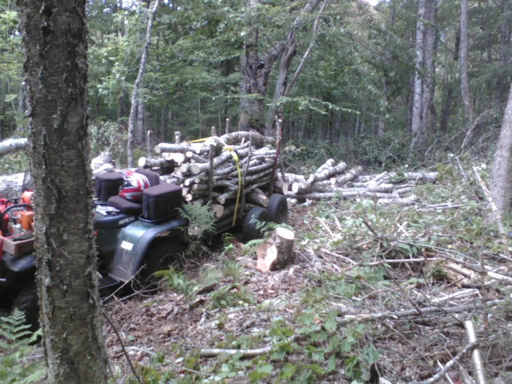

I do the same thing with another trailer, has stake pockets so I put some uprights in those & lay down a few big pieces before piling for bunks:

I found an ms360 this summer for a decent price, and put a 20" bar on it. It works real good doing that. I used that same sawbuck setup in the pic this past weekend actually, cutting up a 1-2 cord pile of smallish stuff in the yard that was anywhere from 6' to 16' long. I could cut the whole thing up with no lengths moving out of place before I got them all cut to shorts. With the 250, I was wanting more uprights to hold the lengths in place better until I got them all cut to shorts. This weekend I cut that whole 6'-16' load to 18" in about 5 minutes with the 360 - walked from side to side a couple times cutting halfway down at a time and working from right to left and things stayed put until I was done with them, and 2 lengths of the 20" bar gets all the way through. That was about 1/4 cord at a time/trailer load. Huge time & back saver, and if you park the trailer right beside where you're going to pile you save more time. I hate moving wood shorts by hand, so the more of it I can avoid the better. Anything too big to get on the trailer I usually cut to length right where the tree landed, tow the splitter right to that, toss in the second trailer with sideboards on it right off the splitter, then stack from the trailer to pallets. That's the last time I touch it until I put it in the fire. Takes me about 5 trailer loads for a cord doing it that way.
You could put this sawbuck thing in the back of a truck too - long as you're careful and don't get your saw into the bed when you're cutting. But it would be kinda cramped & awkward & you wouldn't get as much on the truck - trailer would work way better.

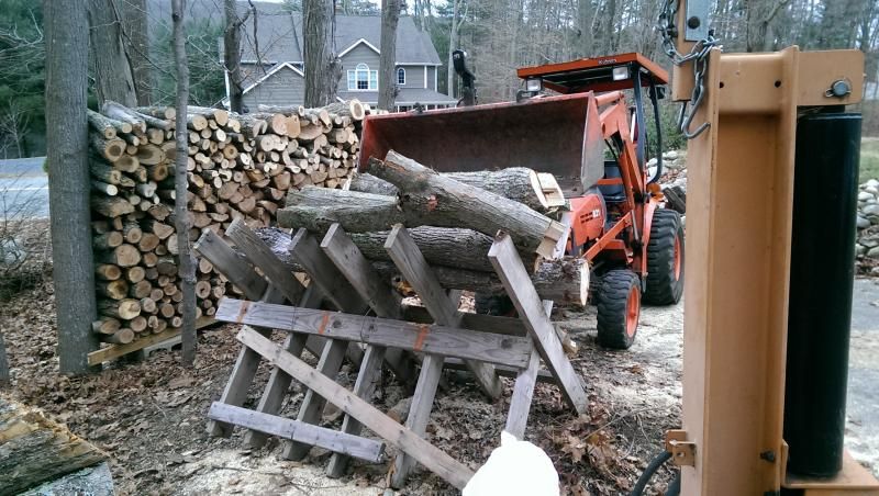

This is how I used my horse today.
Right out of the Kubota into the horse then onto the rack.
