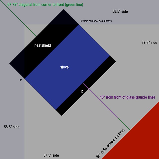

i wanted to pass along this diagram of my plan. does this look kosher to you all? we aren't going to have any wall protection at this time.
i based this off some f500 clearance diagrams the stove store gave to me that don't appear to be in any of the other manuals i found online. they state that the hearth has to come out a minimum of 61.25" from the corner. (along with all the other clearance dimensions). my plan is for that diagonal to be 67.62" from the corner to the front of the hearth.
my floor molding is 1" thick so the clearance to the walls is actually 58.5" plus 1". please take that into account.
when the manual states that the corners of the stove have to be 9" from the wall, they mean from the corner of the actual stove, right? the heatshield doesn't count into the clearances?
i should have plenty of room for the 18" at the front, right? is my math right?
fyi... the actual stove is 16.25" deep, but once you count the front lip at heat shield its 27.25". the width is 28.25"
the gray areas are the hearth

If you go here, under documentation you can download the manual. Looks like it shows the corner measurements from the actual stove not the shield. You'll need double wall pipe or shielded pipe as well.
Look at pages 17 and 18.
Yes we are using a double wall pipe. I have the actual manual as well on my computer. The dealer had some additional papers including a letter from jotul for the local inspector reiterating that the hearth only needs to be ember protection.
I've run all the measurements a ton of times, run it by my dealer, an installation surveyor and the inspector and I'm still nervous :) the install will be done by a professional who is familiar with our town inspector and who does tons of installs.
