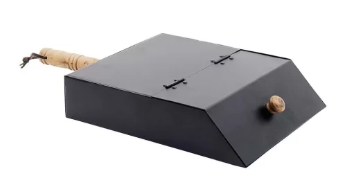

I've never used the ash drawer in my 30-NCH.
After the first year, I started using one of these, work mucho better for both capacity and less dust in the house:
[Hearth.com] MY Englander 30NC has arrived and is in the truck in the shop!!!
