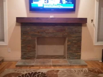

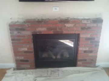

Hi everyone. First and foremost I want to thank most of you for the information on this forum which helped me decide to go pellet and purchase an Enviro M55. The stove is on deposit and I decided to rip out my existing propane fireplace to install a zero clearance "box" for the insert. In an attempt to save money, I did the work myself using the installation manual as a reference and this forum for ideas. Again thank you. I put a before and after picture and promise a finished shot once the stove is installed.

Beautiful work so far!! Does the manual give clearances and materials to use for a ZC Box?
The manual gives clearances and materials. I made the enclosure a little bit bigger than the minimums listed to allow for future stove replacement if necessary. I made the enclosure substantially deeper than minimum and installed a metal boxed outlet towards the back. I'm not sure if this will work to supply power. I hope it works because I know of no other way to supply power without the cord being seen.
If you don't mind me asking, what is the brand of the veneer stone you faced the brick with?

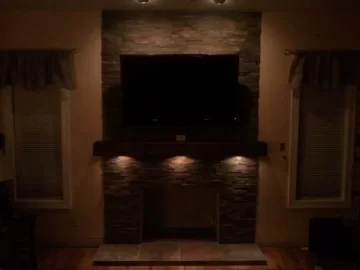

Looks very nice, I especially like the lights under the mantel.
Thanks. I actually had to rip off the brick in order to get the propane fireplace out. I got the veneer from Lowe's. They carry two different types and it comes in 6x14 inch tiles.

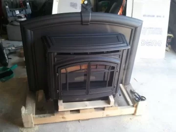

Thanks for the suggestions. My stove dealer charges $600.00 for the install and that does not include venting material. I know I am penny pinching but I also look forward to the challenge. Here she is all lonely inside the garage. I just unwrapped her like a late Xmas present.[Hearth.com] My Enviro M55 install
My installers removed all of the cast iron pieces before moving it into the house. Good luck!

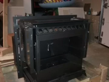

Just stripped it down. Should be a lot lighter once I get it off the frame.
Can it be test burned while in the garage in it's present condition? Nice to be able to make sure everything is OK before the lugging in the house & install.
If you are going to install it make certain you have or can get access to equipment to set the damper properly.
