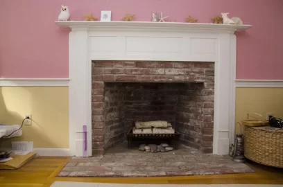

I measured the back wall of an unused fireplace with an IR gun - it's 37F! (outside temp 26F)
The room itself is at the opposite side of my house from the only source of heat - my woodstove.
The fireplace opening feels like a refrigerator.
The damper area is completely insulated with a thick styrofoam plate and heavily caulked, so I am sure
the cold is transferring right thru the chimney brick from outside! Most people would never notice this because
the room itself would be heated, and the brick would warm up.
This just goes to show how well brick conducts heat and how lousy it is to have an external chimney!
Now I know why that room is so cold - wonder if it would make a good beer cooler?

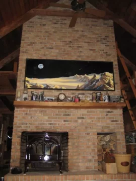

I don't know why more home builders don't design their homes with the chimneys located inside the house. I know it takes up some floor space, but a well built chimney can look very attractive and the thermal heat storage it provides is tremendous. Last night before I started a fire after not having burned all day long I shot my chimney with my IR thermometer and it was reading 87F. Rather than have the chimney working against you an indoor chimney works for you.

Not sure about the painting but the chimney setup is great.:cool::ZZZ
That's a nice setup, and I agree about indoor chimney benefits wholeheartedly.

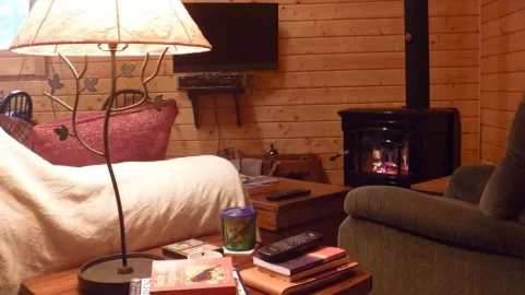

I agree, indoor chimneys are great (except I call mine a flue, single-wall)...;)
