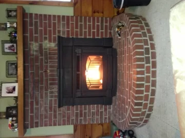

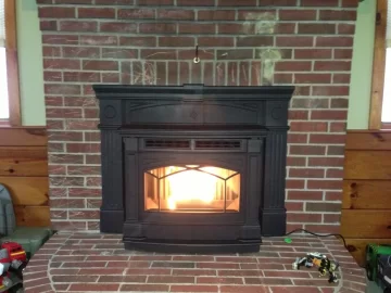

Alright, from reading posts for awhile I realize no pics= didn't happen. Here is a pic and if I do it right a video. The video, even though its hard to tell does my flame look fine. Somewhere between a blowtorch and lazy flames right? Also I was told black tips on flame is no good, I don't see black tips, but the fire is moving to fast for me to see. Thanks
I got caught up in writing and forgot to post pic. Ignore the chaulk and the green slime kids put on bricks

Ahhhhh toasty warm......

Beautiful stove and install (except the cord)...Never seen a round hearth before. What's up with all the scratch marks on your brick (or is that chalk)??
