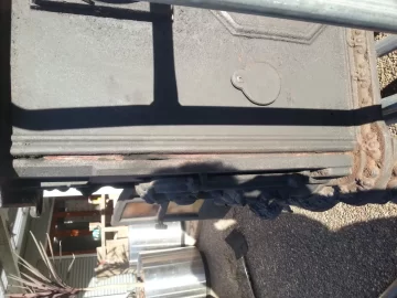

Hi all. I just bought this due to love at first sight but there are some issues. Mainly that it leaks like a sieve. There's flaky rust in the panel joints and the sides have a bit of outward bowing at the back
Can I seal it up without tearing it down? It's meant to be for an outdoor undercover area so maybe doesn't need to be perfect...

Here are some pictures of the back with the bowing.
There are a couple of reasons I don't want to tear it down. I think it is a reproduction so probably isn't worth that much. I am freezing right now and want it up and running and finally, the screws really don't want to come out.

If my brother came to me with this stove I would tell him to scrap it. It's warping badly and that's just its current state of being. This isn't going to get better.
Putting a very hot fire in one's home needs to be taken seriously. You want it to be safe to run and controllable. So far this stove strikes out on both points.

Can you post a picture of the location? Is this area attached to the house? If so there are still high risks. High temp silicone is not appropriate for the red hot temps that are going to happen. This stove is shot. Stove/furnace cement may work temporarily, but the risk is still there. It would be better to clean it up and put it somewhere in a parlor without fire if the look is what is still attractive.
All silicone goes "poof" at eight hundred degrees. Useless for stoves or stove pipe. You can lather the seams with furnace cement. Just don't burn in that thing around anything you can't live without if it burns down.

The primary issue will be a stove you have little control over. That is, you put dry fuel in, light it and off it goes at full strength. Other issues may exist with clearances or the flue system, but so far all we have seen is the stove. Though the deteriorated flue collar hints of additional issues.

i don't see what that hood would do. The problem is that it could potentially be uncontrollable which could lead to a severe over fie that can cause many problems. For example extreme warping or cracking of cast panels which could let fire out. Severe over heating of the pipe and flue which could ignite nearby materials. The stove is beat it would be ok to use outside basically as a fire pit and not near any flammable structure. It isn't worth the risk
