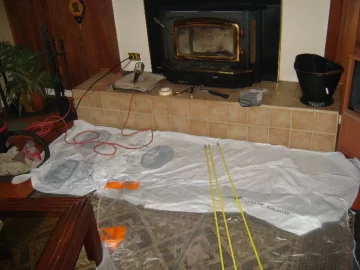

Just for info I had my Regency wood insert model I3100 installed back in 2000 and I have been using it every winter burning about 6 cords of 16” logs. Never had any problem with it and I’m quite happy with it. But I must say I have a problem finding good people to clean the chimney which I do it most of the times every fall, last time been October 2018. Sometimes I had the chimney cleaned after 3 years and the amount of soot was not more than I got today.

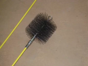

So I decided this fall to clean the chimney myself and I bought a 6” brush with steel bristles along with a set of extension rods and since I’m afraid of heights I had to clean the chimney from inside pushing the brush up.. I had a heck of a time to push the brush up and I had to stop when I was about 10 feet up (the length of my chimney must be about 20-25 feet).

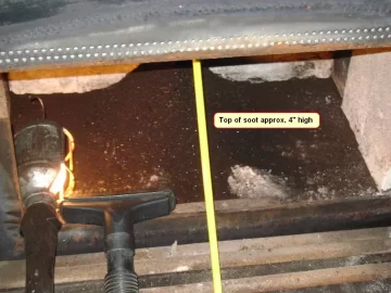

I was surprised with the amount of soot I got by going only half to total height because I remember from the past when I had it cleaned by others I never seen so much soot so I suspect the guys last time perhaps they used a 4” brush?
Since I never cleaned a chimney I was expecting to see only a lot of soot but what I got most was something like granules like the consistency of sugar but they were all shiny. Is this normal? (is this creosote?)

Clay tile or flex liner? If flex liner, I suspect that’s the first steel brush that’s ever been up there, most use poly brushes in flex liners. Could that be why you’re getting so much more?
More importantly, how are you planning to get that brush out of there, if it’s jammed 10 feet up?
You really shouldn't be using a steel brush in a stainless liner

Sorry for the omission guys, I have SS liner and somehow I believe it is like a pipe (not flex).
The brush is not jammed, I was able to pull it down.
The box of the brush says “can be used with SS chimneys) but I will try to see if I can exchange it for a poly brush. Too bad because the first box I got at the store it was a poly brush but when I saw the SS next to it I thought it will be better. BTW the poly brush was more expensive!

Not carbon steel. Liner manufacturers say that can damage stainless
Yes that is stage 2 cresote

I'm assuming you have 6 inch liner.....u never know......stick with six inch brush and as b holler and bashful said get a poly brush. Steel and stainless dont mix. It will scratch the stainless liner and eventually will rust from this.

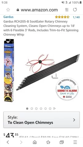

What is “sooteater”?

Stage one is is like a brown dust...easy to remove. It's what u like to see if you have any cresote in chimney.
Stage two is what yours is. Flaky,black, buildup. Not ideal but if you stay on top of it it's not terrible to get out of chimney.
Stage three is really bad lol. It's like tar. Gooey sticky and hell to clean out. You dont want this.

I wish I knew this before, I already spent $75 and not done yet. If not successful I will definitely consider it as an alternative. Looks quite a smart system
Is easy to use, can cut the “brush” to size, and is effective (unless buildup is 3rd stage creosote). Glad I got it a while back.
Definitely creosote, but doesn’t look bad at all considering the size of your stove and the amount of wood you likely burn. I also second the poly brush, the metal one will not do well against your liner/pipe. Sounds like your chimney sweeps are a couple of hacks, I would definitely find replacements, if your not comfortable doing it yourself. I do my wood stove myself, so I know it’s thorough and done right, twice a season. My chimney sweep does my boiler (I’ll gladly pay for that!). He’s a good guy, and even inspects my stove pipe at no charge if I ask him nicely while he’s here. Can’t beat it.

Well, if you spend another $75 on a sooteater (or additional rods for your brush), you'll still have only spent the amount 1 sweeping was costing you before, and you can do it for free from there on out!

The manufacturer of my new liner specifically said it was ok to use a round-wire steel brush.
