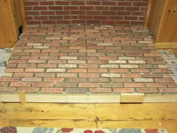

Laid the used brick this afternoon. This time using thin-set. Said right on the box of bricks to use thin-set, wish I used that the first time. Just leaving it alone for two days, then mortar the joints. Used homemade 5/8ths joint spacer for the first row across the back. The rest I just did by eye, just free handing it. Thought it would have a more rustic look. Whoops, should have started in the middle to line the pad stone with the stone on the wall. No big deal, once the stove is in place it will all go away, only I will see it;).

Thanks a lot Begreen. First time building a hearth pad. Learn by doing. Checked the bricks this morning, glued down solid to the Durock, used Polymer Modified Thin-Set . Just misted the board with water then buttered it to my lay out lines each time and a quarter inch notched trowel. Nothing on the bricks, just grabbed them and rocked them into position. Made for a clean job. Going to trim it out in a stained wood.

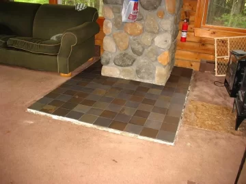

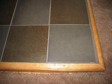

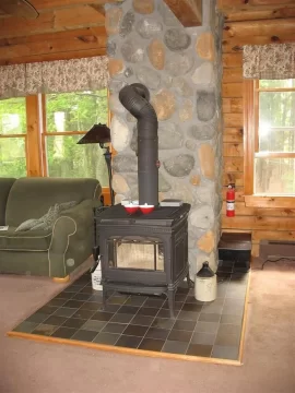

I can only say the wood trim was done after the tiles were done on my hearth. The wood was added later then stained and poly'd. Once this was dry I used blue tape on the sealed wood then grouted from the tile to the wood. The tape kinda worked but I just damp sponged the grout off the wood and it cleaned right off.. I added pics so you can see what worked for me..

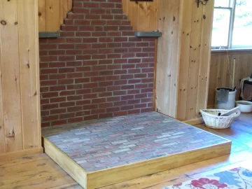

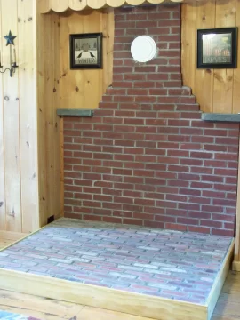

Finished up my hearth pad build,,,,,finally. I kept mixing and the wife worked the mortar bag. Let us make time. Wondering if I should seal the mortar work or not? If I do will the sealant be considered a combustible? Next,,,, setting the Fireview.

It's looking great. Did you wipe it down with a muriatic acid wash?
This is a dry area so I would consider sealing optional. If you seal with a silicone compound it's non-combustible. Your call.
