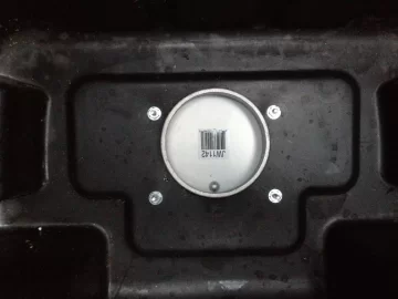

I replaced 4 of the shorter bolts with ones that were 1-1/2" long. Then I just bolted it together from the inside of the can. This picture shows the inside of the can.
  • [Hearth.com] My Homemade Pellet Hopper
Ahh, great---thanks again!
