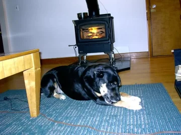

One thing to consider, if you are buying a used stove you may be better off with a welded steel stove.
An older cast iron stove may need rebuilding, new gaskets etc., I have read that parts for the VC stoves are quite expensive. A welded steel plate stove is pretty much bullit proof, there is not a lot that can go wrong with it.
You relly want a newer EPA aproved stove.
There are some great deals on CL, if you are paitient and lucky, I got my stove and hearth pad for about half of what the VC you are looking at.
