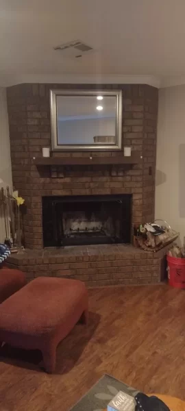

I have a built in fireplace in my house that is very inefficient, uses a lot of wood, produces a lot of ash that needs to e cleaned out all the time, and doesn't put out as much heat as it should. (See Pics)
Years ago my dad had the same deal but he wound up putting a cast iron stove in front of the fireplace and blocked off the fireplace with sheet metal and ran the back vent stove through the sheet metal. This produced a lot more heat and used a lot less wood. I think this is what I should do.
Can you just vent it through the sheet metal or does it need to connect to the chimney?
What are Y'all's thoughts on this? Thanks

No not yet. Don't they still trap heat in the firebox? Tell me what you think.
If I have a cast iron stove sitting on the hearth in front of the fireplace won't that give me the optimum heating? I don't know, just asking. This is a new subject to me.
Not necessarily, but many ZC fireplace do not permit an insert to be installed. Do you know the make and model of the fireplace? If you have the manual search for wording concerning insert installation.
If you want to install a freestanding stove in front it must rear vent and have the top of the flue outlet below the fireplace lintel. Or in this case it could be installed a floor level, losing a chunk of floor space. The stove must be connected to a 6" full-length, insulated, stainless steel liner.
No I don't know the make and model of the fireplace. I just bought the house a year and a half ago.
Look around the door frame channel. Sometimes there is a metal ID tag in there.
My hearth in front of the fireplace sticks out 16 inches. Is that too short for a cast iron wood stove?
Yes.
You also need floor protection in front of a freestanding stove.

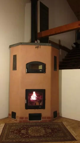

Your fireplace reminds me of one of those corner masonry heaters. Is that fireplace built on a corner? If that fireplace is all brick than it has a strong foundation. But if it is just one of those 1 layer imitation fireplaces it probably doesn't have a strong foundation.
If it has a good foundation, I would rip off the top part, build a core, and an outer layer - that is a corner masonry heater. Masonry heaters are efficient fireplaces that store and give off heat. You could ask a mason what he thought about rebuilding this fireplace to turn it into a corner masonry heater.
[Hearth.com] My Horrible Inefficient Fireplace!
This guy, Matthew Helicke, is nice and you could ask him about the possibilities if you were interested - he isn't too far away. I don't see any masonry heater builders listed in Oklahoma.

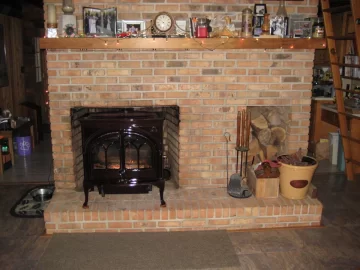

My stove is in the fireplace, smooth wall stainless, plate on the bottom and top with the void filled with insulation no problems.
Yes but is yours a prefab fireplace or a masonry fireplace?
1765 colonial, old brick fireplace that I loved but fear of a fire causing me to make the change, I like the stove but miss the open fireplace but I have two more to enjoy.
I have a setup similar to what you describe. I replaced a slammer installed insert with a Jotul F600 stove that sits in front of the fire opening of my masonry fireplace and chimney. It has a block off plate and stainless steel liner. I lock the front doors of the stove and only load from the side door, which is to the right of the stove. This setup has worked fine for quite a few years.
