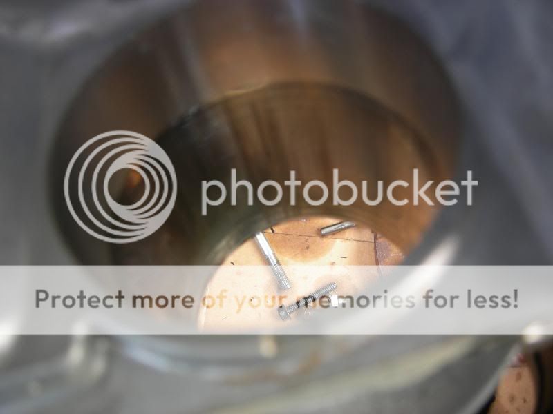

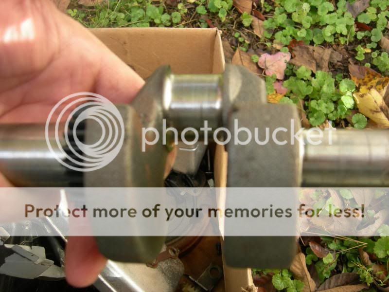

I agree.....you'd think there would be some sort of sign. Something tells me they tore the motor apart, and never checked the key, and assumed the scoring was the issue......I'm not one to argue, just get it running, and get it back in service.....and I will post pictures
