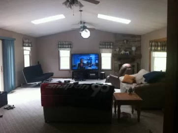

    Thanks for the tips. I picked up two 10" box fans . I'm going to have one by the stove and another at the top of the "doorway" of the 24x22 room that the insert is in to push the hot air to the rest of the house. The huge room was an add on 5-8 years ago. I figure with my celiing fans, and hopefully mostly just the box fans pointed in the right directions, I'll get some decent arflow. The room is huge... that's a 70" Tv in the center... the back, where the picture was taken from is a huge 12-13' opening into the rest of the house. a fan at that opening up top, should help move some air to the rest of the house, at least I hope...

    Oh, that picture was from the first week moving in.. it was a mess.. I've gotten new furniture (my own self bought xmas present!), but only picture I had to describe room size/layout.
    That TV, was one used at this last years US OPEN golf championship for all of four days, Sharp quatros 70" Lcd backlit LED. I got it for about 1/3 the price of new....., that was my perdiem money for being gone three months while my house was closing and the only way i could afford a TV of that size... everyone i worked with laughed because they thought i was getting a dump for the money I paid for this place and wondered if i was going to sleep on it... the room is 22' wideby 24 deep off the house. it really is huge and needed a huge TV to make it "livable" without sitting three feet in front of the TV. The big living room is on the NW corner of the house, so when the WEM was munching (far NW corner), the master bedroom on the SE side upstairs was a good 14-15 degrees cooler than the downstairs. when the fireplace was not going it was only 7-8 degrees cooler. The house was builtin 48, but added on to three different times over the years. So, over time i'll go through everything and reinsulate and make everything top notch. The kitchen was all brand new Kraft Maid freshly done, along with the new master bed and bath upstairs. Anyways, sorry to ramble, kinda proud of my little piece of the american dream-finally. Will be even better once the iron is up and running. Besides, i have to justify my chainsaw collection.....

    Since you have a blower, I wouldn't worry about a fan close to the stove, put it on the floor just outside that room, blowing in.

    blowing in towards the stove, or blowing out heat towards the rest of the house? my thinking is that heat rises, a 10" fan in the top of that big opening would suck alot of that hot, high air out of the room?!

    Not really... Heat does rise, but cold air moves eaiser and is more dense. So blowing cold air towards the stove, will be replaced by warm air.
    Any air moved must be replaced? Right? Your just helping the convective loop of the house. Take some incense and walk through the house. Your may find that the air moves faster up top, or down low in certain areas. Add fans and help the natural loop you have already.
    But the cold to warm is true. It works. Im a firm believer.

    A fan up top blowing out should work well, but since you said you have another fan, put that outside the room, blowing in. The combination should maintain a nice convection circuit. There is not much to be gained from having a fan within in the room, might even make things worse by disrupting the convection.
