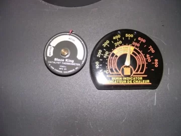

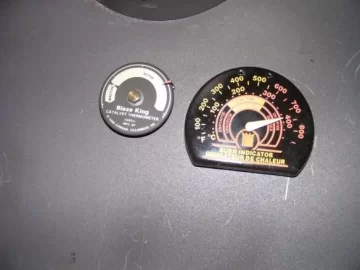

my cat gauge only says active and inactive, it is not a stove thermometer,(well technically it is, with no numbers on it) so I stuck a magnetic one right in front of it. If I am understanding you guys correctly, it can read 800 on the top of the stove? :bug: It's a rutland, it reads 50 degrees hotter than it should, and the scale says 600+ is too hot or overfire. scale goes to 900.

I have only been using the fan overnight on low. I don't worry about overfire because a fire hot enough to cause that would make my house 150 degrees. I fill the stove, but I only run it on high till the cat is generously up to temp, then i close the bypass, and turn the stove down to med/low to low. If left it on anything above med after that, I would have all the windows and doors open.... :coolsmirk:
You may or may not have room over-top of your cat. Your thermometer was actually meant for single wall stove pipe in reference to stack temps. Just read the #s.

mine is about 3" in front of cat gauge. won't fit like that unless I remove the stovetop shroud, which would actually be a good idea because I could put a kettle up there also for some humidity.
between 450-500 is comfortable without the fan. It's only in the forty's outside though.

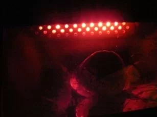

Your cat should be well into the active zone. Low settings are designed well for this stove. No need to run the fan. Your t-stat will just keep the damper throttled longer. @ 300 f it will run for many hours on a clean burn. AS long as your CAT was active before the turn down and your wood is dry. Cheers. N of 60
AND remember your stove temp will go up for a few hours after the turn down, even though your flame is out. That extra smoke created is alot of fuel for that cat. You should be able to see your CAT glow for the first 3-5 hrs after turn down. I will read 700f + above the area of the cat @ this time but below 600f every where else.

perfect! thanks n of 60! I dont see the cat glow for very long, but it remains well into the active range for hours and hours. it only glows for a few minutes, but the gauge is pegged at the upper limit active range. Me thinks that could be because of the different wood we are burning. you are probably burning ALOT hotter and faster than I am with pine. maple is a slow roller, so is alder.
