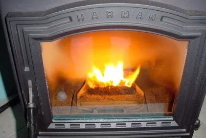

My new Harman P68 glass has residue that won't come off - glass was replaced this week and is formin
I just can't see how this happening. I know you are saying it is not a cleaning issue, but just how does the glass get to the point you are saying? These are high temp glass panels, and I can see if you had some fault with one, but two? This is some strange situation you have on your hands. I have let my glass get super dirty and nasty with all kinds of deposits on it and have never had a problem with cleaning it. I have the P68 as well, and once I shutdown for cleaning, all I use is some Windex and it comes out clean as new. Yours sounds as if it is actually melting or something, which is hard to believe, just some crazy goings on inside your stove. There has to be some adhesives of some sort getting on the glass, or some real funky pellets burning in your burnpot. Looking forward to hear what the outcome and cause is on this. Here is a picture attached of how nasty my glass is right now, the picture doesn't look no where near as bad as it really is. It will clean right up with Windex. Good luck with yours, keep us posted.

Dianac said:
Good morning,
the flame is still hitting the glass.
So you're saying the flames are actually hitting the glass directly? Is this happening intermittently, or consistently? Looking at the last picture in post #7, the flames do not appear to be hitting the glass. If the flames are hitting the glass, something is not right. Since you said this has been an issue since day one, the burn pot could have been built incorrectly causing the flames to be shot out at an abnormal direction, but this seems pretty unlikely and you would mostly likely see such a gross defect. My best guess (assuming the flames are actually hitting the glass) is that the combustion blower is blowing too much air through the burn pot which is forcing the flames to blow out onto the glass. If this is the case, you should see signs of a lean condition, such as heavy white buildup on the glass. If so, this can be adjusted on the board, but it's something you would want the dealer or the factory to handle. If they do decide to tinker with this, have them mark the position of the pot before they make any adjustments so it can be brought back to the baseline if need be.

Looking at the pictures of the burn pot, there appears to be a ton of buildup there and we can't see any of the air holes. Are these burn pots and flame guides model specific? The factory could have easily grabed the wrong parts when assembling.

you are getting direct flame impingement on the glass, the residue is literally cooked onto the glass. i do not know the harman design well enough to give you a direct reason for why the flame is impinging this way , but its nearly impossible to get the stuff off , trust me ive tried to with glass samples which ive handled from our stoves. to correct the issue you will need to figure out why the flame is getting up against the glass the way it is and change whatever it is thats causing it a well drafted properly operating pellet stove should not impinge like this. im thinking an air issue of some sort, or a blocked or restricted airwash setup. wish i could help you more, but thats what the cause is.

I'm sure Mike is spot on. The flame should not be hitting the glass, it doesn't even come close to hitting the glass on my stove.

My opinion is that this stove is way over fired for some reason. If you look at the metal around the opening where the door shuts, that's all cooked too. I have the p61 and no mark like that at all. If any grey/white would be present from burning, it would be in the top right and left corners of the glass and not in the middle. Again based on my p61, essentially the little brother of this stove. Im not a betting man, but i would on this... to much fire at some point in time and its getting cooked!!! Don't fire that thing up and leave it until you get this resolved or at least a good answer.

The stove is finally fixed! It was not a "cleaning method" issue. Harman gave us a new dealer as our original dealer didn't know what was wrong and could care less. Harman ended up sending Hearth & Home and they were terrific! There was a leak in the door and the door was replaced, the flame guide was eroded and replaced; the company we purchased the stove from didn't bother to put a clean out t in, so Hearth & Home redid their installation. Our stove works great, the glass cleans with simple windex and we have a beautiful flame.
