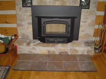

I was to get a new Regency I3100 installed today after paying in full about 2 weeks ago. Was to get a new insert with liner and new hand made hearth pad for in front. Also to have my old insert removed and put in my garage for future sale. I paid up front to save about 5% from what the sales man said.
Then he called me last night and said he was backed up and would like to wait till next Wednesday since his area which is north of me about 75 miles had snow 3 times and had others ahead of me.
So we are scheduled for next Tuesday now for my new I3100 and I will update this report when its installed. I knew there were some waiting with baited breath for this report and thought it was proper to post.:)

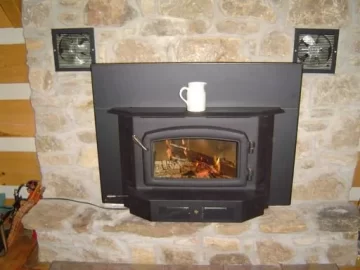

I posted some pics of my new Regency I3100 today and due to having to resizing them they are not in order. It does put out much more heat than my old insert, but not as much as the salesman said. The house is a bit warmer, but its not really cold out yet.
Have a thermometer and ash shovels on order to help in taking care of it.
Thanks
Shipper

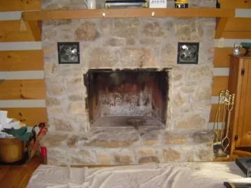

Looks nice Shipper. Was a block-off plate installed below the chimney damper?
Since I had my chimney sweep do the first install with my Appalachian insert all he did was knock out the damper pin and take out the damper plate. It left a hole for the new installers to run a single run of liner from the insert up to the top of the chimney. They did put some insulation up in the damper area before putting the surround on.
So to answer your question, not that I am aware of. I had stuffed all kinds of insulation up in my fireplace above my old insert and it didn't help in the heat output of the Appalachian. The new Regency does put out more heat, but will not heat this log home as the salesman said.
Shipper
Stuffing the stack with insulation is a common cheat and not the same. And it's not even safe, especially if they used regular fiberglass insulation.
A block off plate has nice advantages and is especially helpful with exterior chimneys. Without one, the stove is trying to heat the mass of the chimney. Might as well try heating the great outdoors. We've had several posters recently that have seen a significant improvement in stove heat output once the block-off plate was installed.
