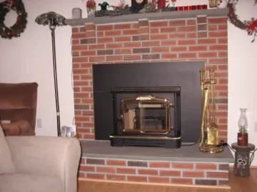

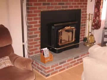

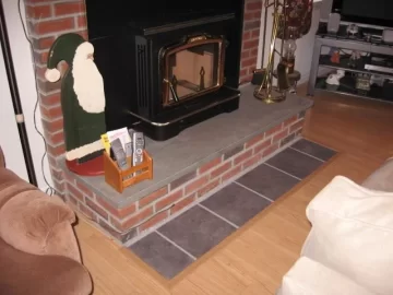

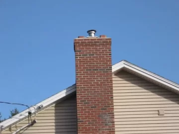

Our new Harman wood insert was just put in today.Looks like a cool weekend here in th NE so planning on starting to break it in then.Heres a few pics!

Very nice lookin' setup you have there!!
Enjoy!
Ray
Very nice looking insert. You will get many years of use from it.
Y E S ! Very pretty indeed. You should have many hours of enjoyment coming your way. Great good luck!
Very nice, but it looks like you need more hearth (18" is code now).

Yes i know!Im planning on cutting out a foot of the pergo floor along the front of the hearth and installing ceramic tiles.

That is purdy. Not a big fan of andirons though. Looks like they might limit the size splits you can get over top of them.
Yeah, I think I'd lose the andirons too...just a lot of wood burning going on in there, it's so pretty to watch, nobody will notice the andirons getting all dirty. We had a "conversation pit" covered over, an old masonry fireplace bricked up and a new hearth built, with all the required clearances from everywhere...and I'm still going to add about 12" of ceramic tile over 1/4" durock around the hearth. I've had sparks and glowing embers make it to the carpet even with the required 18" in front of the stove. Be safe. Rick

Nice setup. Are those andirons connected to the door frame? I can see how that would be a good option to keep logs away from the glass and not get in the way of reloading.

They seemed to be bolted with one half inch bolts just inside the door opening.After a few loadings i should get a feel if they are getting in the way or not.I do like the idea of them keeping the wood from falling up front and into the glass.The inside has 2.6 cubic ft of wood space and will handle wood up too 20" long.

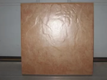

I made a trip to home depot on my way home from work today and picked up all thats needed for my tile extension in front of the hearth.I ended up with 12" ceramic tiles that should complement the color of red brick of the hearth and the color of the wood pergo.I will be putting in one row of tiles adjacent the the front of the hearth with some nice flat wood molding around the outer edges.Heres a pic of the tile.I do have a variable speed blower thats attached on the bottom and blows air out of the top front.The only thing i dont like about its a little noisy at the higher speeds.

I think that'll look very nice. We'll be doing something similar this year when the room gets ripped apart for a kitchen redo & new hardwood floors. Our Lopi has a blower kit, variable speed, and yes, it makes a bit of noise, but it's so effective that I don't think I'll ever have a stove without one. Have fun. Rick
The tile i bought really didnt look right when i placed next to hearth.Since the mantel top and hearth top are both a gray slate i think it may be best to get a color that will go with them.I found a 13*13 tile that is whitish with gray in it!this will have to do.Boy!! do i hate doing this color matching stuff.The tiles are going in this weekend!i will post a pic soon after.

Yeah, having looked back at the pics you first posted, I think the gray will be better. I can do all the scut work, I usually leave all the color details to the wife. I suggest you put 1/4" Durock or equivalent on the subfloor under the tile...better base for the tile, and more non-combustible insulation. With a nice trim piece around the sides, even if you have to custom-craft it, to make the height transition smooth, it should look great. I'll be doing pretty much the same thing later this year. Rick
Going to have a small delay on the stoves first lite.The simple tile job i thought i was going to have is taken longer than i thought.When i cutout the pergo i then remembered the messy mortar job that was done when the hearth was first built.Its going to take alittle time leveling that area adjacent to the hearth for the tile.Hopefully will have that done today.
Well!It was more work than i thought but its done.Now i can breakin the stove.
