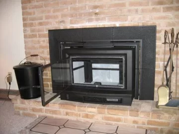

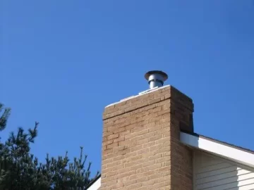

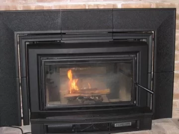

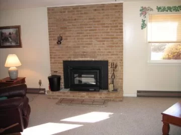

The installers just left, and I think they did a pretty good job. The inspector is due in on Monday. :)
Rhon, I took your advice and had them switch the door and install it with the stove pulled out as much as possible. I got a good look at those air channels you were talking about.
I'll post some pictures of my wood pile, and such on the pictures forum.

That is one nice looking stove and installation.
Enjoy!
Wow, it's weird seeing someone with the same thing. Like, seeing someone with the same car.
It looks like the surround is a little low, looks to be slightly blocking the heat channels. On the bottom of each leg of the surround is a levelling bolt. Simply unscrew it until the surround lifts up enough to line up with the tops of the two channels the heat comes out. If you want to take the surround off (it's probably 40-50 lbs) to do it simple lift it up and away. I know you probably can't waite... don't be surprised if the glass gets covered in black during the burn in procedure. Water and smoke cause dirty glass, and you'll be surprised how much water is going to come out of the soapstone during break-in. When you start burning some nice hot fires you shouldn't have a problem.
I will do that on the surround. I see what you mean.
Thank you for all your advice. and your right, I cant wait to fire it up :)

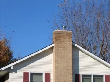

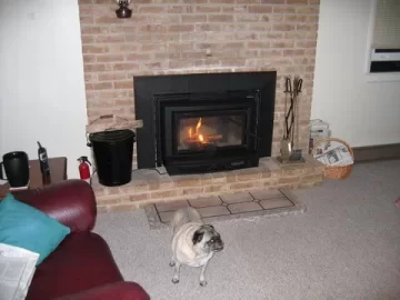

We have ignition.....and my dog approves!!

Yes this one was a little one, and you would not believe the moisture that "weeped" out of the stone. I have one more small one scheduled tonight, maybe one more on Saturday to be safe, and then by the looks of the weather report, I should be able to get an inferno going Sunday!
And, remember to do that each fall. This fall when I started the break-in procedure I wasn't expecting the soapstone to weep again, I'd used it 24/7 last winter but, it wept.
