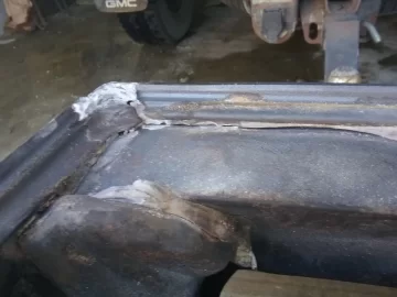

Back plate says made in 2006. Previous owner said its only been used twice in the past couple years. No cracks in the casting. Burn plates and secondary baffle appear good and straight but it looks like it needs some re-cementing underneath the top plate. I plan on taking the baffle out and doing a thorough cleaning, may even paint it while it's all apart. Anything else I should look for?

Looks pretty good. Examine the inside base around the grate carefully for hairline cracks. Jotul uses a special refractory cement. I think Hearthstone uses a similar material and sells it too. Repaint with Stove Brite Metallic Black in a very well ventilated space and/or with a good respiratory protector. Acetone fumes are nasty.

You can use Rutland, but the Jotul/Hearthstone cement is better and like factory. I think the ashpan assembly acts as a bottom shield though there is one available in Europe.
