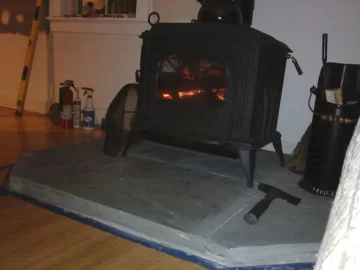

New for me, my Resolute Acclaim. I hope the pic gets to you all, I'm new here. I cannot tell how invaluable the information is here.
Before I blast out a bunch of questions, I read up and down and all over about how to install a chimney and to build a hearth here.
I decided on Bluestone and I think I like it, I'm still trying to figure out how to clean it tho. I still have to trim it out with some maple I have lying around from my kitchen cabinets.
I hope someone can hit me up that has a little passion for the 2490.. Man do u guys hammer that stove.
Well it's a fairly bad pic here but maybe u all can see what I've been working on.

Nice, I always liked how the Acclaim looked.
I'm still trying to figure out how to run it with the damper closed. I can keep it fired up around 550 to 600 with the damper opened but once I close it it seems to slowly cool off.
