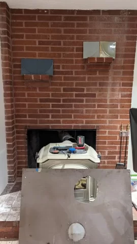

The piece of sheet metal resting on the wood stove is what they used to separate the fireplace from the room.

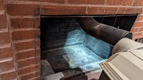

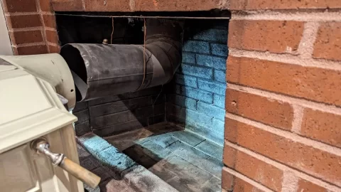

I'm not expert, but I've been digging into Oregon code, it appears the chimney needs to come out of the top of the wood stove, it can either then go straight up, or change with a bend. This backwards "L" shape set up we currently have is not to code.
I've had one company out, they advised because of their licensing, they couldn't help with the current setup. Now that cold be BS speak for they don't want the job, but they did pull the code out and we discussed, and I've looked up more on the state website.
I've got another company coming out Tuesday, I feel better informed to ask more questions on the subject.
In theory we could bust a hole in the brick, but I don't want to do that.

That makes no sense at all. Manufacturers instructions on ul listed stoves over ride code requirements. And there are obviously rear vented stoves made even today.
I gotta 2nd this.. The OP should talk to a qualified installer
