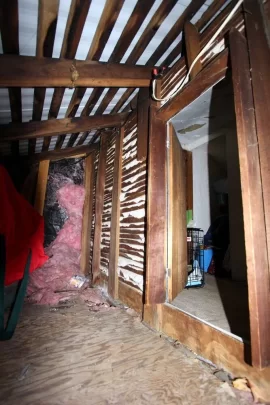

The plaster walls/ceiling has nothing between the plaster and the underside of the metal roof. There is fiberglass on the attic floor though, beside the bedroom, but that’s it.
[Hearth.com] My pathetic insulation situation. Ideas?
Other side of uninsulated bedroom.

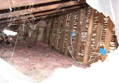

The eave end. Didn't realize it until I was reviewing the pics but right there in the middle is an old brick chimney (not used).

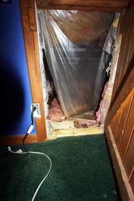

Here is the door into the attic on the insulated bedroom. Neither attic door is unsulated, and this one has fallen down crap right in front of the door.

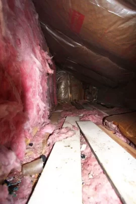

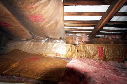

So this room is insulated.... Everything. Floor, walls, roof, eaves... with plastic under the insulation up against the metal roof (directly touching the metal).

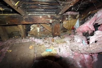

There appeared quite a lot of condensation, and some of it has fallen down (I presume due to the weight of the condensation).
So some questions. Where the heck to begin. Super limited budget currently. Might not even be staying it this house for very long. But open to ideas. Though I'd love to just dump this place, I figure its going to take me a year or two to fix it up enough to be even sell-able without taking a severe reaming.
So I have a lack of insulation in one room, too much - along with improper use of plastic in the other, and no ventilation at all. Can anything even be done to the ceiling parts without tearing down the walls/ceilings? I don't see how i could get anything in there really, its only 4" between the wall and the metal roof. And I'd really hate to tear down a perfectly good wall when there is so much else to do. But open to ideas...

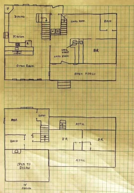

Hey thanks fellas. Sorry for the delay, on my days off I'm not always on the forums. Plus I realized how confusing this was and wanted to draw out a better floorplan. So here goes...

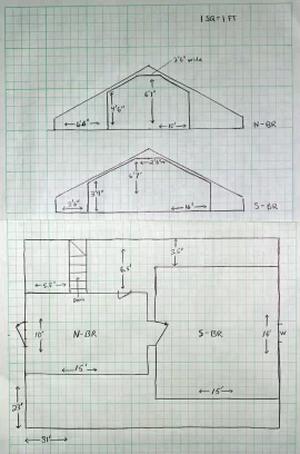

Drawn fairly closely to scale. In the original drawing I drew both bedrooms the same width for convenience (and to be honest for a long time I didn't even realize one was wider due to the way the closets and built in beds are positioned).
There are 2 bedrooms in the upstairs area, north and south (N-BR, S-BR). The N-BR is not as wide. It is the one that is plaster walls, without any insulation on the knee wall or ceiling. The S-BR, appears recently redone, with drywall, and is wider. This is also the one where they insulated everything (floor, knee wall, roof, and eaves) as well as put up plastic under the insulation that's under the roof/eaves.
Also, the old stairway that comes down from the N-BR cuts off a 5.5' section of the attic that is inaccessible. I assume no insulation. I forgot to draw it in, but there is a small doorway into the attic in the other side of the S-BR, so both sides of the attic are accessible except for the first 5.5' of the N-BR.

Step 1: Unless there is a good reason, all the insulation on the 'ceiling' can be pulled down, and repurposed to insulating the floor. Wet insulation should be bagged and discarded. People get weird ideas and DIY insulation in attic in strange ways. All that poly sheeting has no function up there...I would just pull it out too.
I'm assuming most of the ceiling/roof insulation is wet. But I wonder the stuff in the 4" gap in-between the ceiling and roof if it can just be pulled out or does it tear?

Currently, the attic floor is only 3.5' wide on each side of the 23' width of the floor (if i redid the other bedroom to match), would it really be worth putting all that extra insulation in just two 3.5' strips of the attic? The ceiling is going to be limited to much less so I can't see putting a huge amount of insulation over a small area to be much benefit. Would also make it very difficult to get into attic since that would be almost half the height of the opening you'd have to crawl through and I doubt I'd be able to get around in the attic with that much insulation. Wouldn't be very much room left for ventilation either. I don't see needing to get into the attic again once finished though, so if putting that much into those areas would help I'd still consider it.
Honestly, I'm still not clear on the geometry. I don't know why you would ever insulate the roofline in an unused attic space, rather than the attic floor and sidewalls (if any).
You are describing 'knee walls' which are a bear to airseal and to insulate. The more important thing is to make sure the framing is not wide open to the outside air. The way kneewalls are usually built leaves the joist cavities under the conditioned space open to the unconditioned attic. Just stuffing something non air permeable into those joist cavities could be huge (and fast/cheap).
You should google and read about airsealing kneewalls and cape houses to get your bearings. There are lots of resources on line.
Once their sealed, many people just have the whole space filled with cellulose.
It is a used space (bedroom). Without the roofline insulated, like half of it currently is, then the heat goes straight up into the atmosphere? My IR gun on the ceiling of the bedrooms often reads 50's (or colder) in the winter and over 100 in the summer. If I insulated the floor, it would completely cut off the bedroom from heat, not to mention I'd have to pull up carpet and plywood. Maybe this diagram will get us on the same page, since I might not be using correct terminology...
So this is a cross section of the upstairs bedroom. The red lines are the 'attic' space that I would insulate (probably just FG batts). The floors already are, but one bedroom has nothing on the vertical part of the red line (I assume that's what your calling a knee wall?). My question is the yellow line, the ceiling, which is nothing more than plaster, 4" air gap, and metal roof. And its probably close to 20 feet of surface across.
That clarifies.
Read this: http://www.energyauditingblog.com/the-difficulties-in-heating-cape-cod-style-houses/
I assume you have an arrangement like a 'Cape Cod' house in some areas, and a more conventional attic elsewhere in the floorplan.
