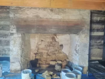

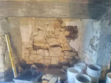

Just cleaning up and stabilizing it for a gas stove to go in
  • [Hearth.com] My project for the next couple days

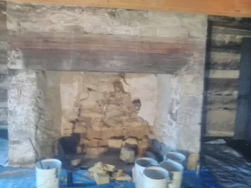

Part way on the back wall

There is no kneeling or working on your back on this one. It is 5' tall. And I have a tender. It is cheaper for the customer for me to have one. But regardless this isn't cheap.
Looks like a wood lintel. Is there wood up in the chimney too?
Yeah a couple wood poles across they used to hang meat from to smoke. And beams go into the chimney but not through.
