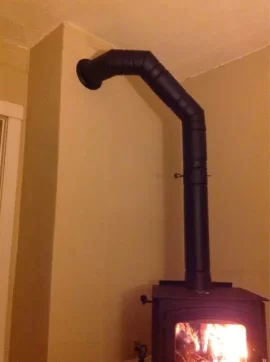

First the stove (Drolet Baltic). Love this workhorse. I'm getting 7 hours, on straight pine, with the stove top at 500-600 for a few hours, then slowly coasting down to about 200, at reload, on a nice large bed of coals. The chimney, at least until the liner arrives, is about 22' (from stove top) of internal, clay lined, 7"x12". The 6" insulated liner should be hear within 10 days. The stove pipe is Selkirk double wall, about 6' from ST to thimble. Actually, I can't believe how well this thing drafts, being what it is. Even cold, I can feel and hear the draft, with an open stove door. No OAK, yet.

Looks good. One thing though (It doesn't hurt), you don't need a pipe damper with EPA stoves. The primary air control will choke down the airflow plenty, to keep the majority of the heat in the firebox.

Yea, I didn't figure I'd need it, in the end. But with the open top, masonry stack, I thought I'd be better safe, than sorry. Turns out, it was twenty-some bucks I didn't need to spend.
Sounds stupid, but we always had them, when I was a kid, so I like the look. As long as it doesn't adversely effect anything, after I install the liner, I'll probably keep it. And just as probable, never actually use it. ;-)
Sentimental I am.
Thanks for the suggestion, though.
No better words could be said when starting and maintaining a fire INSIDE your home. Not paranoia, but a solid respect and a "check it - double check it" plan is always a good practice no matter how seasoned a wood heat burner you are. In the event of an "oops!" moment that key damper may save your shorts from a little mess one day :)
If you leave the key wide open the only time I see it being an issue is when cleaning the pipe - just a PIA I would imagine.
You also may find an OAK unnecessary depending on how tight(or not so much) your home is. I have thought about adding one to my 30 but really don't think it would change anything at all. My home is rather drafty with not so great insulation at this point and a doggy door that opens and closes periodically throughout the day. Run the stove for a bit and see - may be an option you can forgo and in some way recoup the cost of the damper.
