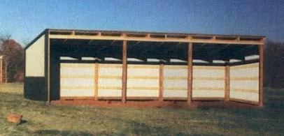

I hope to start working on a shed in the very near future. I have a whole bunch of old metal roofing panels from when our roof was replaced last summer due to a hail storm. The panels are 16 feet long. They were rough cut from the roof during the tear down. (picturesbelow) In other words, they were cut between the seams, rather than pulling them apart at a seam. They all have three ridges/seams in tact and the cuts were made between seams leaving several inches overhang on each panel. Basically, the useable width of each panel is 28 inches. I will overlap each panel using the excess on each side. You can see in the pic below how much overlap there is, which should make them easy to attach without messing with the seams.
The shed will be roughly 16 x 12. The panels will be laid down lengthwise (to avoid cutting them) in an east/west orientation. I will have one end of the shed slightly higher than the other for drainage.
I'm going to use 8 ft 4x4s for my uprights, set on Dekblocks. 2x6s all the way around for facia/headers. More 2x6s lower down on three sides for lateral support. 2x4s for joists attached by joist hangers. I will have a center post on each of the two 16 ft sides. Not sure yet if I'll need a center post on the 12 foot sides?
I want to keep this as simple as possible and hope to not have to do any cutting of the metal, but if I do.... can I do it with a circular saw? I don't want to buy any special equipment, just the necessary blade, which I assume needs to be a carbide tipped blade.
Also, how should I attach the metal roofing panels to the roof framing? There will not be a solid, plywood deck, just 2x4 framing. Since I am using deck screws for everything else, would deck screws also work to attach the panels? I would have to pre-drill the panel before inserting the screw.
For what it's worth, this shed will be in a wooded area completely surrounded by trees. Not much wind gets through back there.
Of course, a portion of this shed will be dedicated to firewood. The rest is for tractor implements, etc.
Any tips or advise is greatly appreciated.

) I screwed my panels right into the 2x rafters, although I had to nail in a few supports here and there (this shed build was no framing feat, I kinda just wung it)![[Hearth.com] My shed plans: Metal roofing. [Hearth.com] My shed plans: Metal roofing.](https://www.hearth.com/talk/data/attachments/125/125547-7e68bb188248e1682498933dc5e73e85.jpg?hash=b3JafYzyMo)
