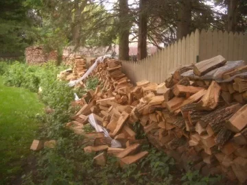

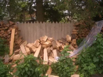

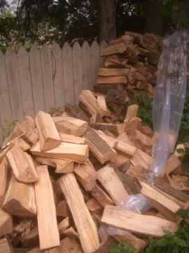

Well, I came home yesterday and 2 areas of my stacks fell over. I can't tell if they simply let go, or someone pushed them. When I stacked them, I was pretty careful about the bottom and had 2"x4" frames supporting them. I actually took the time to tie a loop of heavy cord around some of the middle logs and then to the fence parallel to my stack. It was working beautifully. About a month ago, my neighbor asked me (nicely) if I would remove the cord as he thought is was pulling on his fence. (It is his fence). So, I cut the cord and had free standing stacks. I hope the stacks fell over on their own (one area did have a little lean). But I also hope my neighbor didn't lean over the fence and push the stacks over!
I'll have to move on to plan "b" with this stack.

Being up against the fence, they are drying against the fence slower than out in the open. Hence the lean towards the open side.
Could be. Most areas are pretty straight. The two sections that fell down are easy for my neighbor to get to from his backyard. I suppose it could also have been my kids who knocked them over. (12 year old twin boys!)
Probably the neighbor reached over the fence and gave your leaning stack a shove. I had a real jerk of a neighbor once who's fence leaned badly toward my property from his kids climbing it. I would prop it up from my side with sticks and he'd reach over and knock my sticks over. He accused my kids of breaking his fence.

Agree, the stacks have to be off of the ground. These stacks are on bricks with 2"x4" "runners". The logs are laid across the runners. I think I went too high on this stack. Some areas are 5-6 feet high. Maybe that's why cords are measure 4 feet high? Oh well, I restacked and put some braces in there. We'll wait and see.
