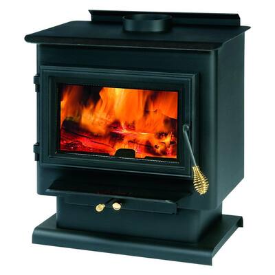

I juggled the idea of an insert but ended up going with the Englander NC-13 freestanding stove. For the price it couldn't be beat. $600 after a 10% discount! I hope to get a few years out of this and then upgrade to a big boy once funds allow.
