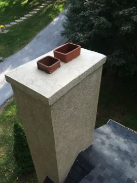

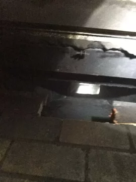

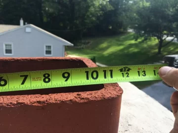

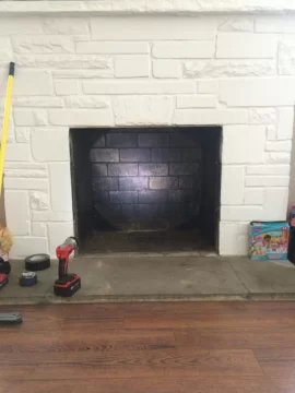

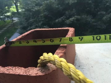

Thanks for the info. Just opened up my fireplace and checked it out. Super clean, good size at 6.5"x10.5" ID terra cotta. I was able to cut and hammer open enough space for the install. I'm ready to go. I have 16' from stove top to chimney top. Should I go with 12' rigid insulated and 4' flex uninsulated or run the rigid to 15' and tie in the additional foot w/ flex?

6.5" is going to be a bottleneck for round insulated pipe. You may need to go with rigid oval, then transition to round after getting past the damper.
I think you are right. the 6" pipe's OD is 6 5/8" :(
Looks like there's a ton of options for converting between round and oval. Is there a preferred choice?
