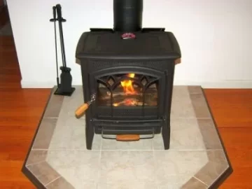

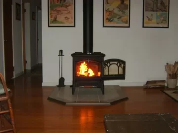

I bought a Hearthstone Craftsbury. After burning with it awhile I figured out I should have gotten a bigger stove. So far it throws plenty of heat but the firebox 1.5 is too small. It only takes a max 17 inch log. If I were buying again I would get the next size bigger with a side load door. Live & learn. I didn't do enough research first and let the salesman steer me wrong, not the first time. So if you are shopping for a stove do your research.

First of all you've got a mighty fine looking stove there, and if you can burn in these temperatures with the door wide open like that (without spilling smoke), it looks like you've got a good install and good draft. So lets focus on the positives first.

That's a beautiful stove and a beautiful install. You should be proud. As perhaps the only person on the forum with a smaller firebox than you (1.25 cu. ft VC WinterWarm small), let me give you my top ten reasons why small is beautiful:
