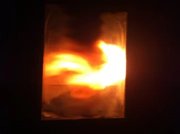

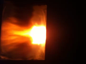

There are many different methods. I don't have an ignitor in mine. My preferred method with 91% isopropyl rubbing alcohol. Let me go find a post which I put pictures on how to.
The stove is burning like this after the rubbing alcohol way. Kinda scary...

You used a tad too much alcohol. It'll burn off. I did it once, it make a whooshing noise. Haha
