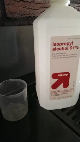

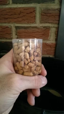

After trying a bunch of methods, I find this one to work perfectly and consistently consistently: I stole a plastic cap off a detergent bottle, not the giant ones. I fill the cap with pellets, pour in a small amount of 91% isopropyl rubbing alcohol (they sell it at target). Let it soak for 20 seconds and dump that into the burn pot, with the stove on. Lite it with a bbq lighter and close the door, after about a minute I turn the auger on. Of course common sense must be used when using a flammable liquid.

The 91% isopropyl rubbing alcohol method works great, takes seconds and the door only stays open as long as it takes you to press the button on the BBQ liter. I can usually turn the auger on in less than 30 seconds.

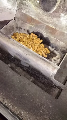

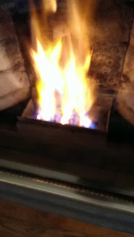

Alcohol method. Fill cup with pellets, pour in small amount of alcohol, let soak 30 seconds, dump in pot, light, close door immediately. After 30 seconds to one min turn auger on.
PS, I know I need new fire bricks. I'm just being cheap. Haha
It only took me one match last night. I even had the cheap rubbing alcohol too, only 70%.
Reactions: Ranger72
I got that large bottle from target for just over 2 bucks. It'll last memonths too!
