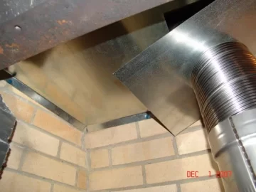

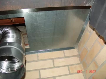

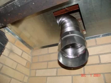

6 inch ss 16 ft run comes off the stove into a 30 degree elbow and then a little s so to speak because the flue is to the left of the chimmney non insulated interior chimmney

16' aint so bad, that elbow although a 30 degree might still count as a subtraction on the chimney height. So its stove, 30 degree elbow then 16' of flex?
That block off plate does have another pc to cover that rectangular hole I assume? Still sounds like woods not ready. But if it is, the only other thing I can think of at the moment, is try and temp an additional few foot (4' or so)of the cheap galvanized 6" duct from like lowes or home depot on at top just as a temporary test to see if draft improves. Better draft may or may not help your coal problem also. For me at 27'. my draft is intense to say the least. Which also may be why its easier for me to get & run at higher temps more easily.

yes its stove 30 elbow then the little s bend as the flue is off i nthat dir. def not the wood no hiss.. no bark if it is it falls off and very light in weight
i made a collar in order to give me some play with the plate when installing

Ah yes now I remember. I was/ am very impressed with that block off plate. You & the installer did a real nice job on that.
Nice & tight. Much better than mine ;)
